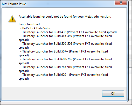

We'd like to assist you with getting you up-and-running. We are planning to release a launcher update for Build 950, however this will not address the issues with spread. The best bet is to roll-back to Build 910 at this stage. Could you describe what problem you're having with using Build 910 so we can help resolve it?

I have replaced the terminal and metaeditor.exe files to the 910 build but still I cant open the platform through the tickstory program..
Here is the notification...
Many thanks for your help
