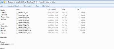

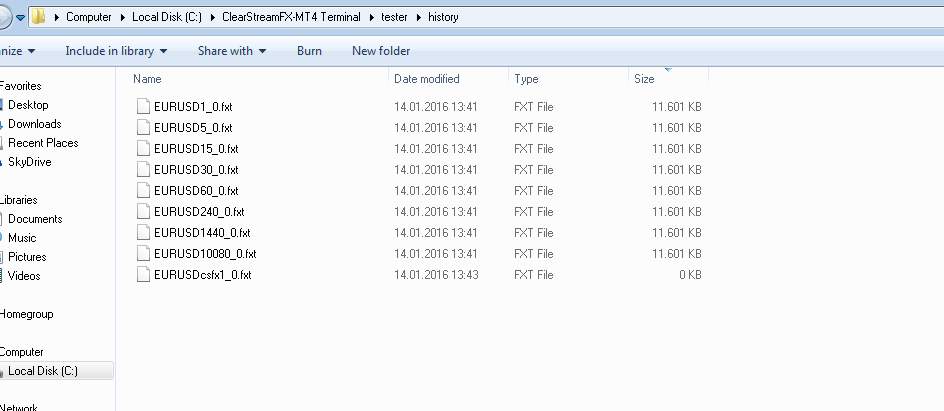

I downloaded the data, I exported it, no error message, and it seems to be in the folder (see screenshot).
Still, the strategy tester does not accept and says "no data".
Any idea?

Hi Fractalfreak,
Make sure you have not selected "Use date" in the Strategy Tester and try again. It appears that you may have selected a back-test date range that is different to what you have exported.

I tried that, then the strategy tester jsut takes the last 6 days...
as soon as I try to define a time range (which I made sure that it was downloaded before), it does not work.
Any idea?
I saw some similar issues reported for the new MT4 update...
Thx
Re: issue with strategy tester
If you are using Build 950, the current recommendation is to work with Build 910. Please see here for more:
http://tickstory.com/forum/viewtopic.php?f=2&t=902
